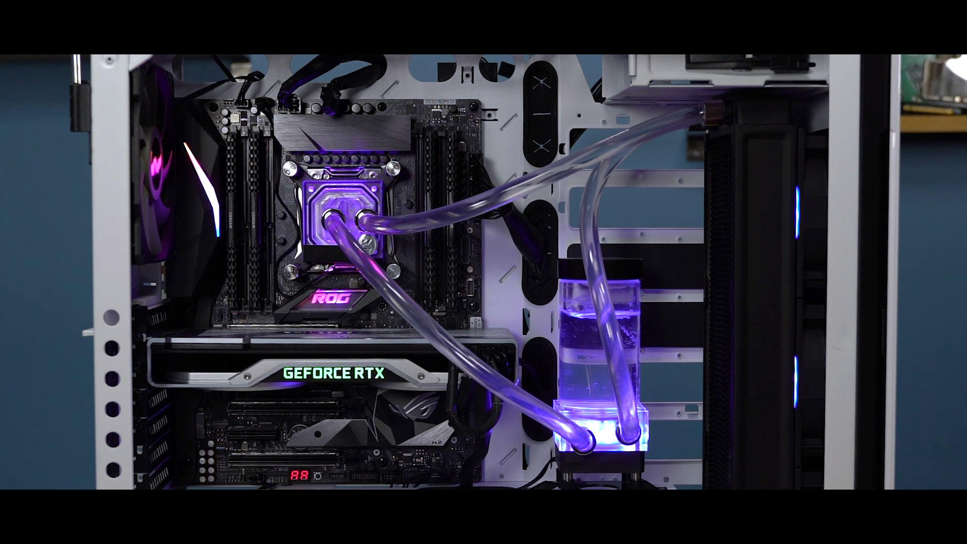

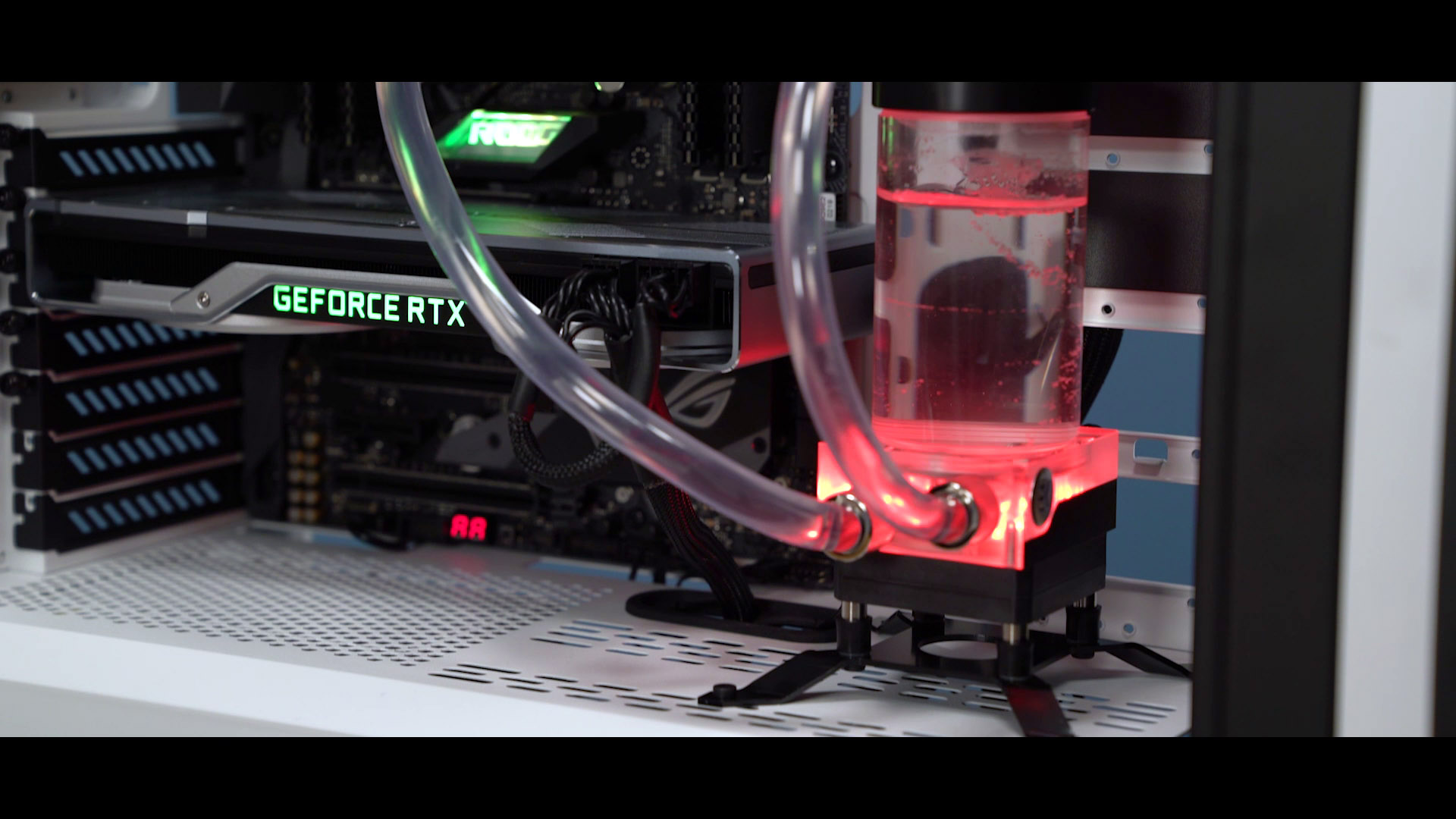

In terms of the installation process, this kit is a bit of a mixed bag. Some of the parts are really easy as you would expect, but a few more optional extras like a pair of 90° angled adaptors, a reservoir clip mount, and a fill bottle (and by extension an Allen key for the fill port) would have made everything leagues better. Coolant concentrate is fine by us, but just remember to pick up some distilled water before assembly. The RGB implementation across the board is rather nice, even if it's not digital. The pump RGB in particular looked rather good, and we like how the LEDs are in the base rather than on a cap like you'll find on the Thermaltake and Corsair RGB reservoirs.

The pump, however, definitely didn't light our fire. It had trouble pushing out all the air quickly from the radiator, which doesn't fill us with great hopes for adding more radiators and blocks to a loop. Sure, it didn't seem to hamper performance, but then pump speed doesn't tend to affect things a whole lot. Unfortunately, only EK can comment on the reliability and capability of the included SPC pump. While we doubt it would have chosen a dud, it's definitely more comforting having a regular DDC or D5 present. Other kits from EKWB do of course come with those pumps, but you're then looking at a higher price point to match.
